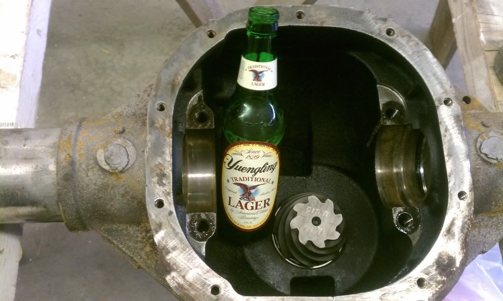

tomorrow night i’m gonna give the housing a good cleaning inside and out and hopefully, maybe, depending how many beers ive consumed, start on gear setup… :question: :open_mouth:

gear setup…well i got the housing cleaned out

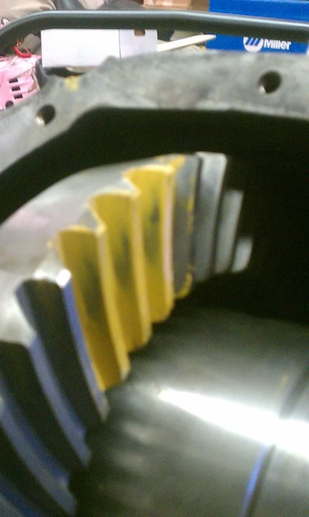

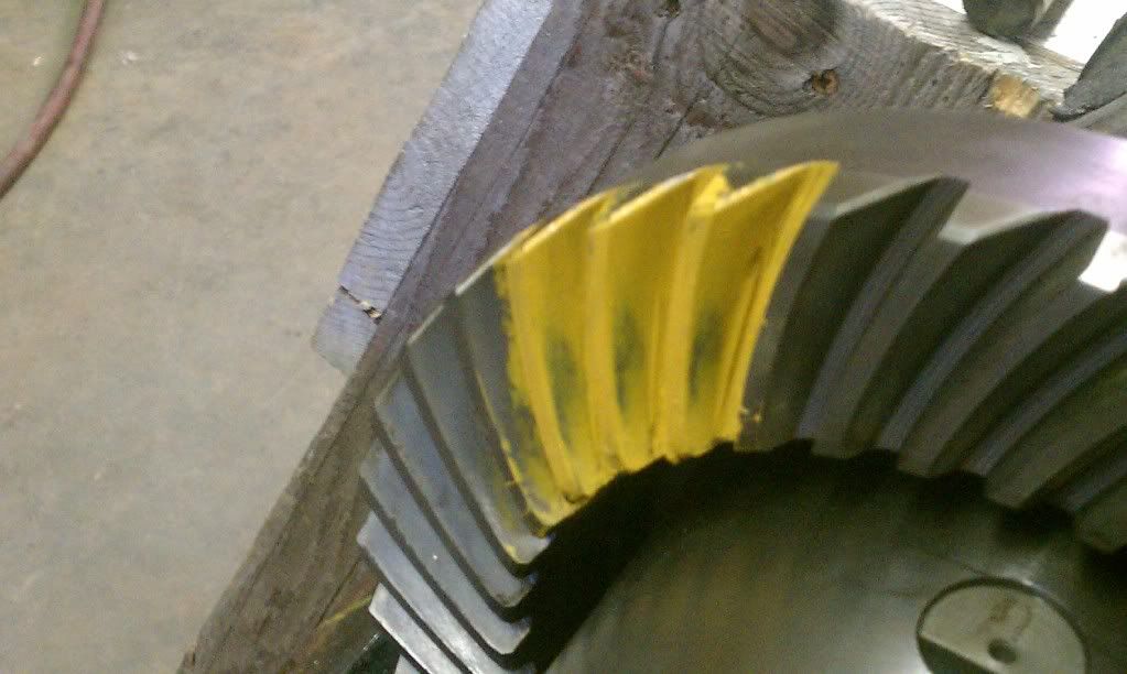

we hit road block (beer) after road block (pizza). we at least figured out what our pinion depth should be. although the measurement stamped on the pinion is taken from the bottom of the pinion head whicjh makes it much more difficult to dial in.
we’re gonna give it another go saturday in the light of day where i hope the distractions are minimized :laughing:
ahhh. got the gears all set up. thank god for my friend dean. doesnt seem all that difficult to do, but i do not have any of the specialty tools to getherdone. the photos showing the wear pattern are not the final setup. we broke it down one more time and added a shim to the pinion. the wear pattern after was much more precise. my only minor concern is pinoin preload. dean did not have a torque wrench capable of measuring the small amount of inchpnds needed for the preload. he did it by feel, and im taking his word for it as he has a pretty good mechanical background.
