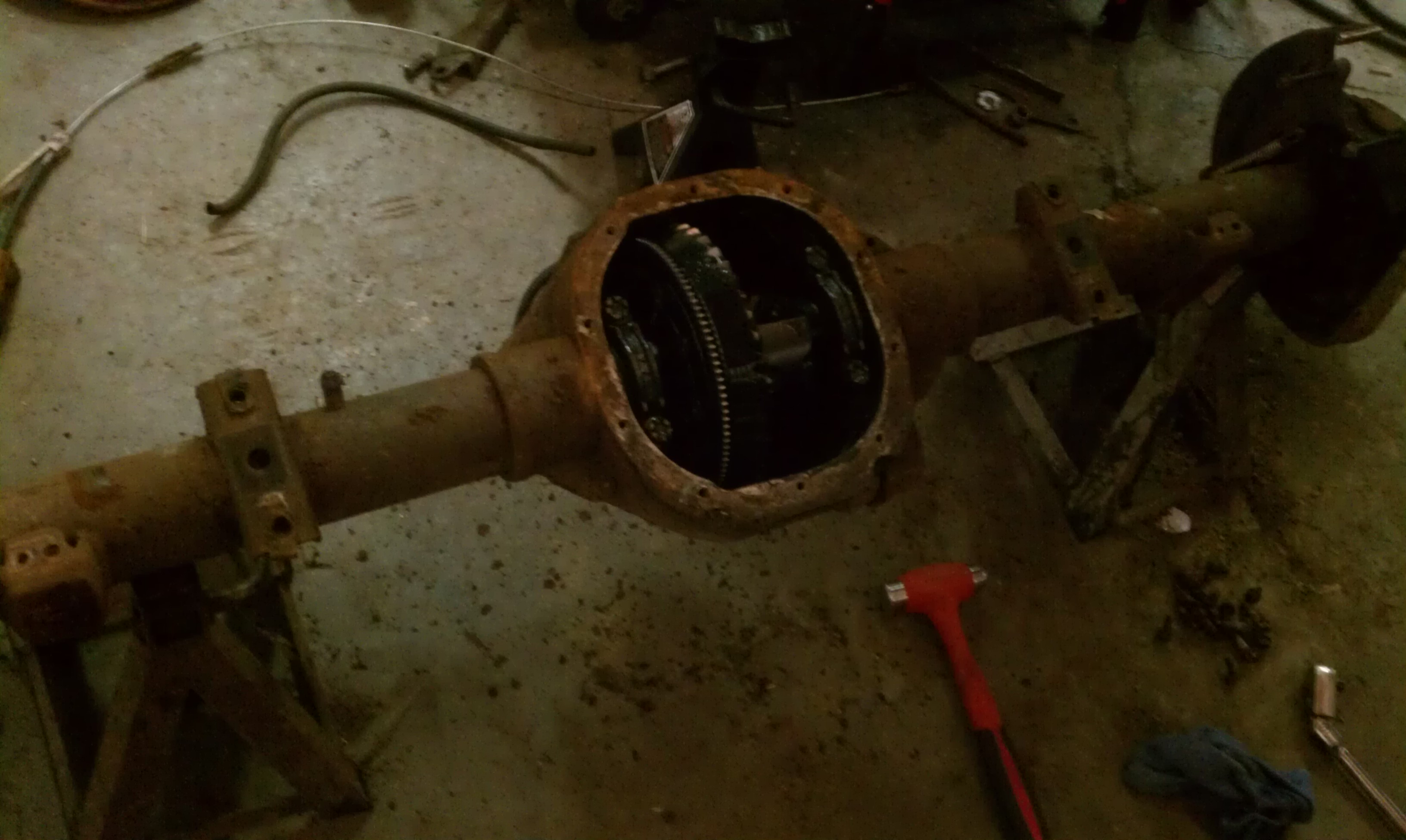

finally tor into my long awaited ford 8.8 build. didnt spend too much time. got into the pumkin, removedsway bar, brake lines, calipers, rotors, axles and carrier. tomorrow i’ll prob cut off all existing mounts and maybe start stripping the axle tubes and pumkin. wish me luck
take ya time cutting off spring perches as not to cut into axle tube (ask me how I know). did ya buy new perches yet? I think I used the install kit from more
Haven’t bought any perches yet, but was planning on buying that same kit. I’ve read several build threads on the internet warning about cutting too deep. I’ll proceed with caution but can’t guarantee anything
the insides look pretty clean. mine had so much freak’n rust it took me hours just to clean it all out. new bearings on the outsides to? mine were toast

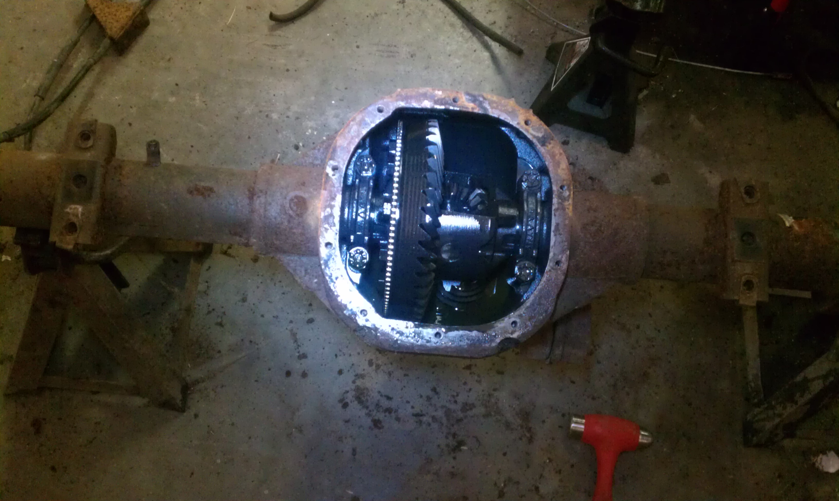

got all the old bracketry cut off tonight, since eric doesnt like any of my photos, i will not post them.
hopefully some time next week i can get the housing all cleaned up and ready for regear. also seems that the rear brakes will need considerable work $$$$$

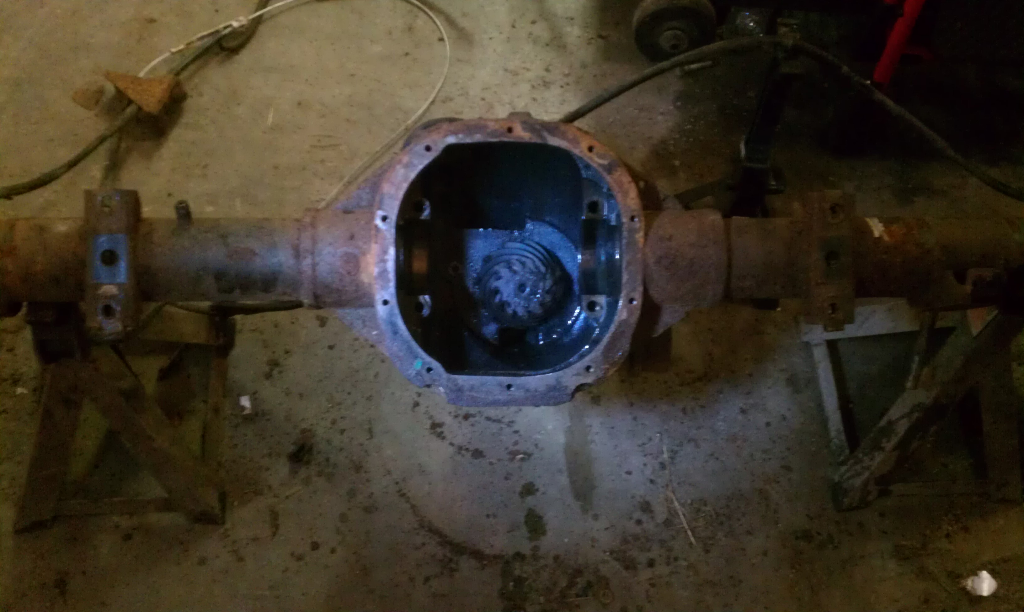

baby steps. looks like i chose the right friends garage to do this in. he has a sand blaster, the pumkin will be blasted hopefully later this week…then on the gears i guess

Jay do you have to cut the ears off the ABS sensor and trim that flange off the housing on a YJ? i ended up having to do it for my TJ because of swaybar clearance. Also i didn’t end up having to move the bleeder at all not sure if that is going to be an issue for you or not.
Are you talking to ears on either side of the abs sensor? I shouldn’t have to, I have no sway bar in the rear. And what flange are you talking about, the one near the pinion output?
