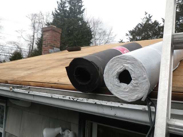

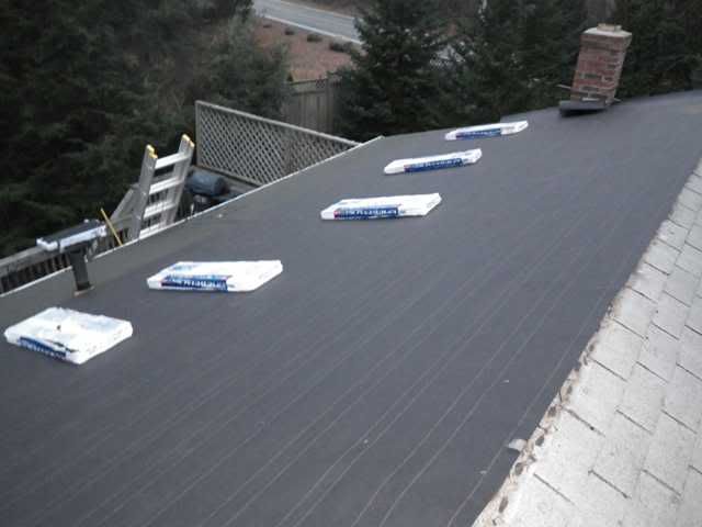

Progress:
Just over 2 hours to strip the old and clean it up then another 2 hours or so to lay down the ice & water shield, felt, and lug up some bundles of shingles. That stick-on ice & water shield is sweet. I’d like to do the whole roof with it instead of just the first 3 feet but it would triple the cost of the job.
I’m going to prep the starter row tonight and then start bolting down the shingles tomorrow.
