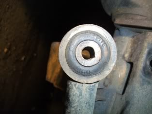

I’m just trying to cure a case of DW that just started to show it ugly face when i drive 45. i went under yesterday and tightened everything i found loose, namely the alignment adjustment collar but i still have a minor case. I’m kind of thinking it’s my axle trackbar mount but I’m not sure how much, if any movement should happen at that bushing. let me know what you think.
Yes i believe your track bar bushing is gone and that would add to the cause for the "DW’ also make sure your stabilizer bushings are nice and tight :wink:
Forgot to point out the last track bar i had on the Chief was only 2 months old (Made in China), must of been bad rubber or something :unamused: no wonder there are so many peep’s in China :laughing:
Way too much movement on the track bar end. You can’t really notice any movement on mine.
Is the first picture the bushing? It does not look obviously bad to me. The problem I typically had was the holes on the mounting bracket elongating. Fixed it for good with a new bracket made from 1/4".
i had that problem, because the lift my jeep has had another hole drilled next to the stock hole…
fixed it by welding a washer to keep the hole from elongating
ya, thats what i figured. i’m just going to order an adjustable track bar. it was on the list of purchases for the build anyways.
