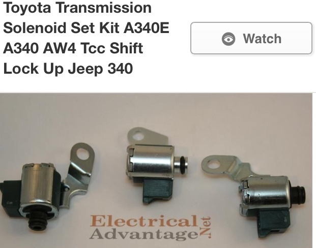

So I need your help, Im going to be replacing the solenoids but the ones I have been finding are EXTREMELY expensive and I really would like to spend as little as possible.
I was told I could run a A340E in it.
I found this on Ebay for dirt cheap so Im wondering if its possible to run
This Yota Solenoid Kit in my XJ.
m.ebay.com/itm/331114055132?nav=SEARCH
