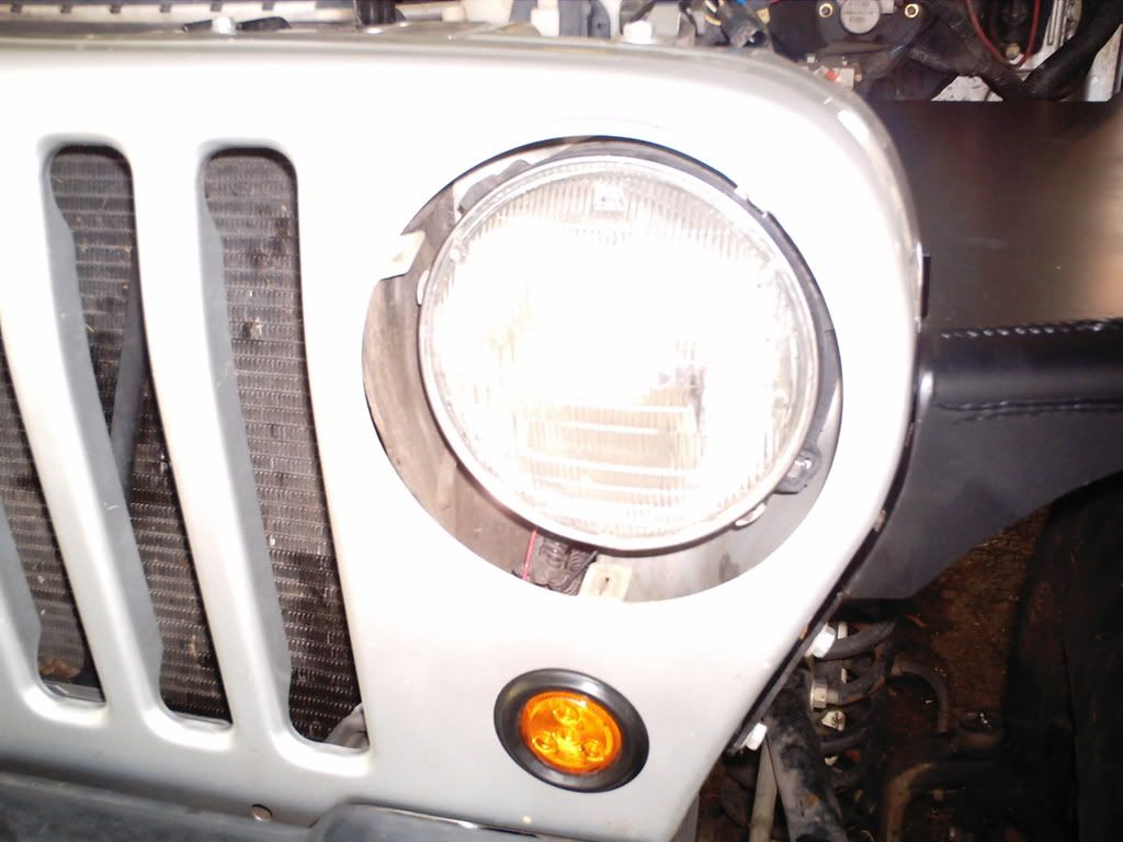

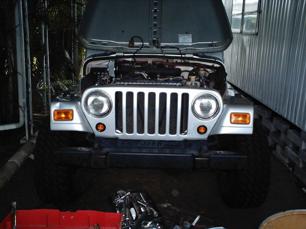

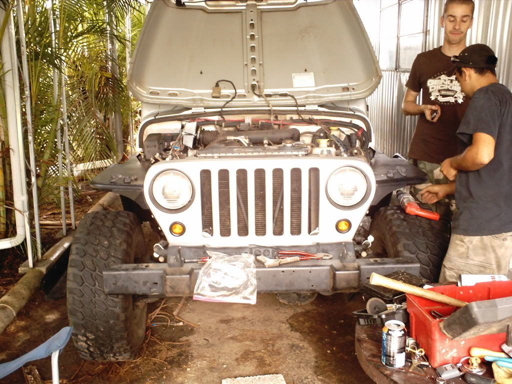

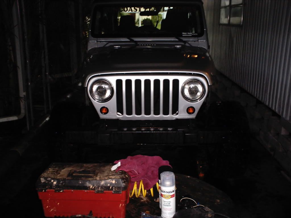

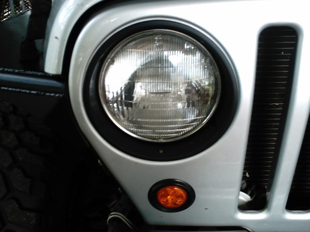

To Prepare For Losing My Turn Signals That Were Built Into My Fenders, I Installed Some 2 1/2" Amber Marker Lights In The Grill
Optronics MCL-55AK Amber, or MCL-57AK Amber (Can’t Rember)

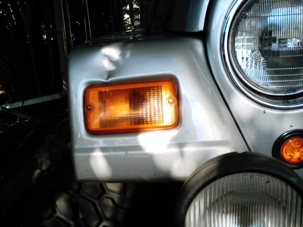

what i started with… i installed new turnsignal ligths 2 weeks ago in preperation of this install.

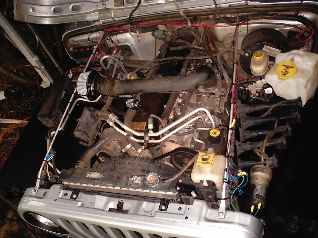

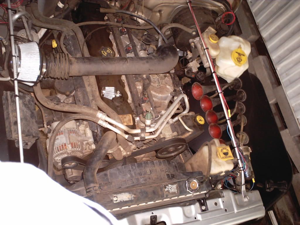

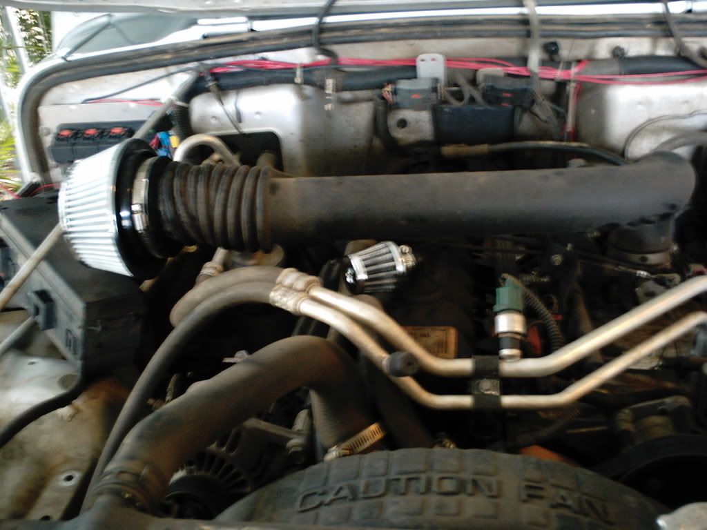

here is my homemade warm air intake (or cai… i belive the only true cai is a snorkel)…
i used a univerisal 3inch cone filter and a univerisal breather cone filter

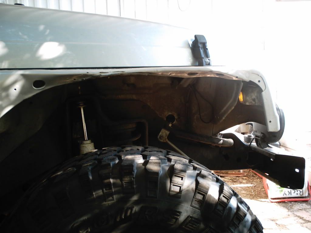

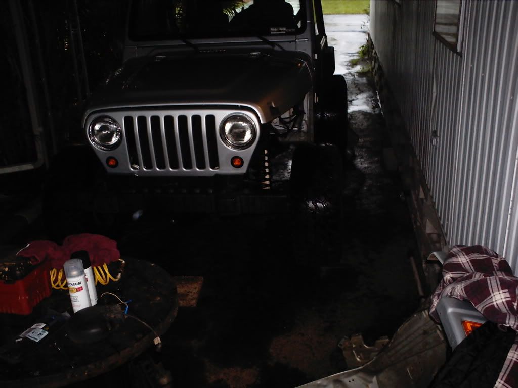

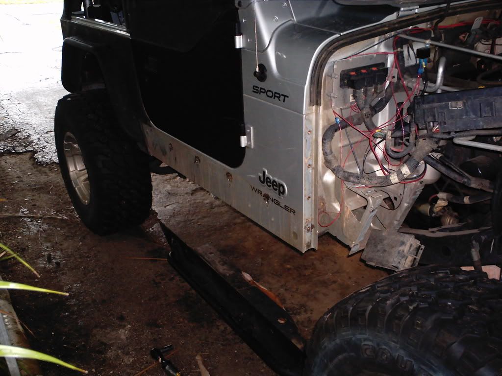

pass side removed…

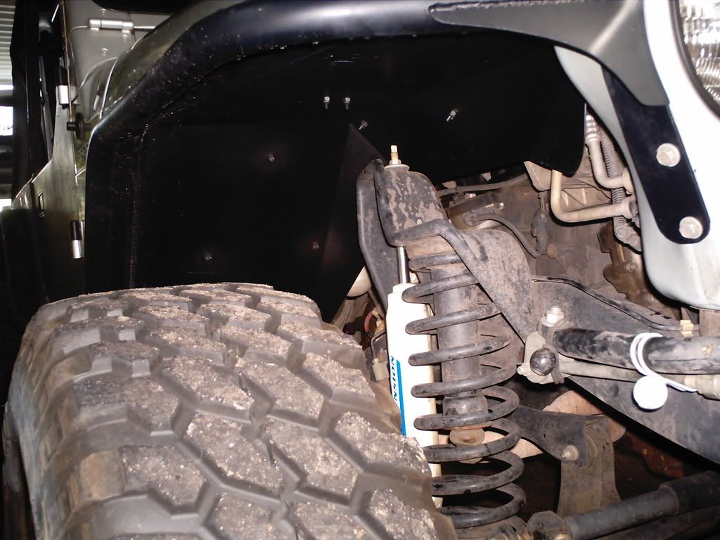

had to drop the sliders for the install  ![]()
side view fenderles

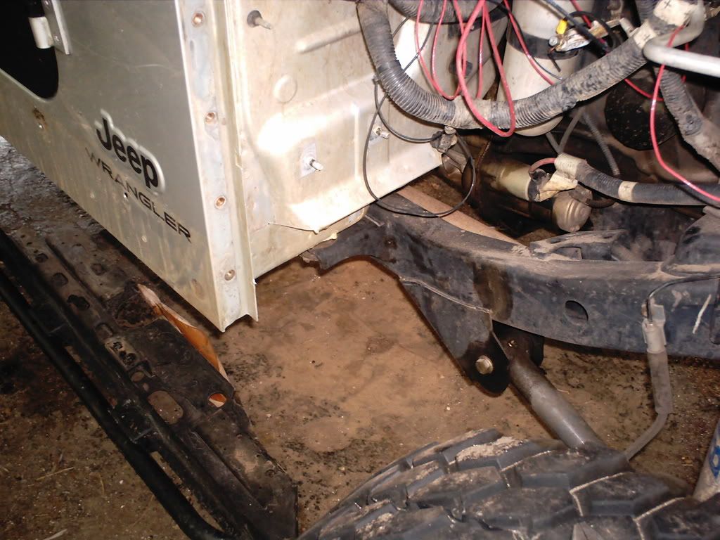

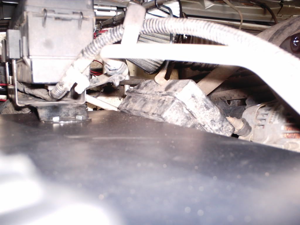

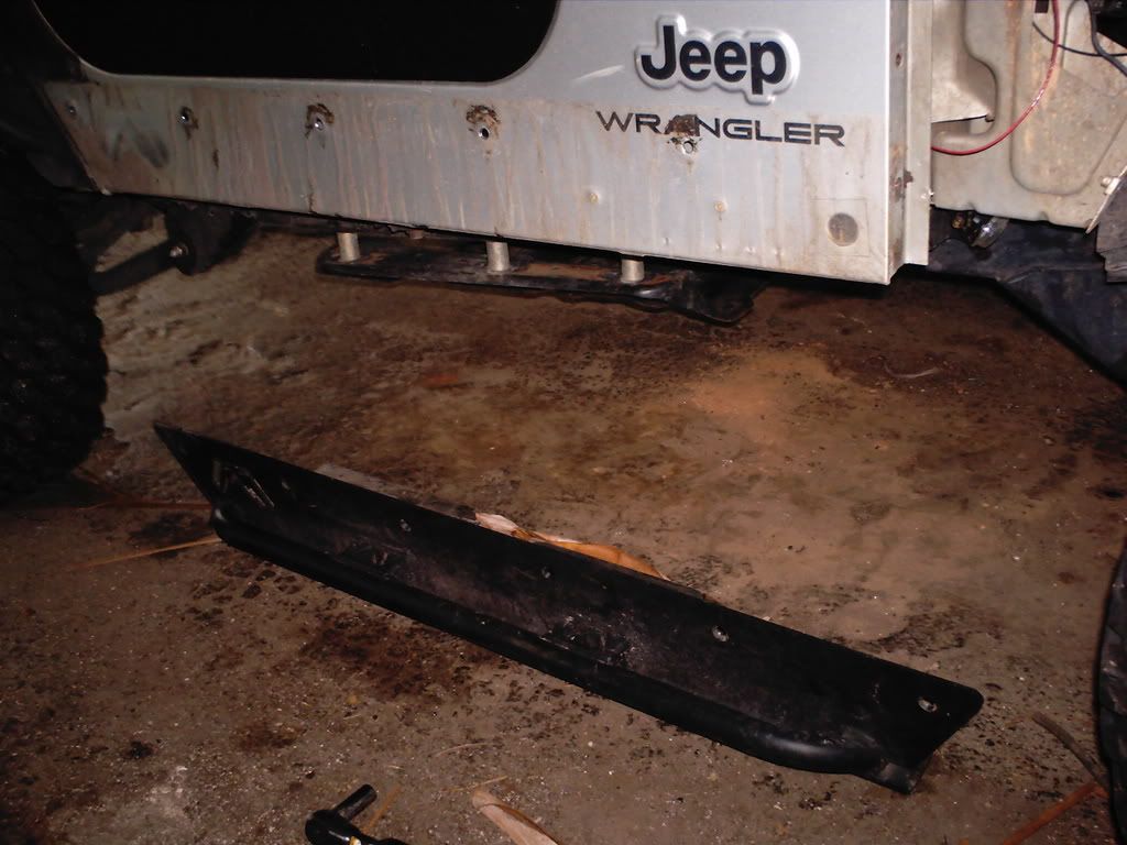

pass side with inee fender support removed (this is what the battery is bolted to)…
drivers side gone!..

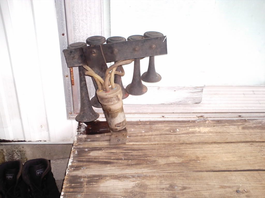

my dixie air horns (which were bolted to the driver side iner fender support with was removed. so now i have to discover a new home for them ![]()

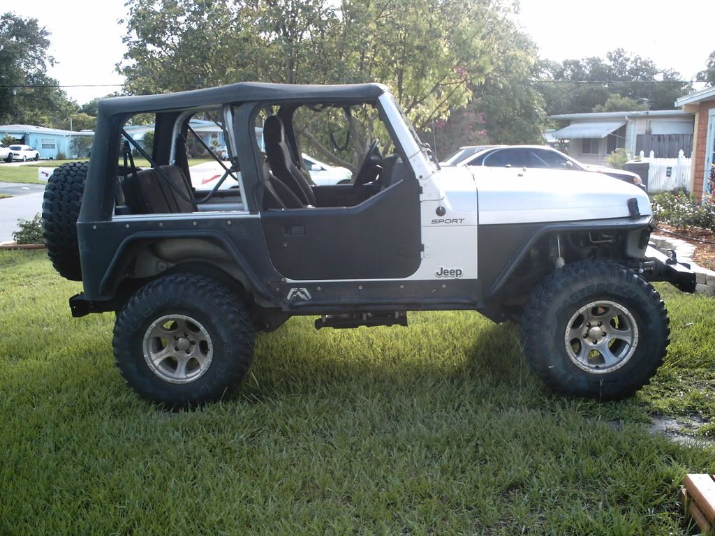

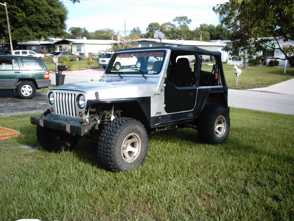

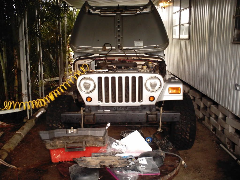

finished the flat fender install today!

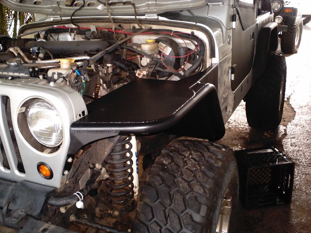

first we monted the fenders losely and removed the head light bezels…
driver side shot
pass side shot

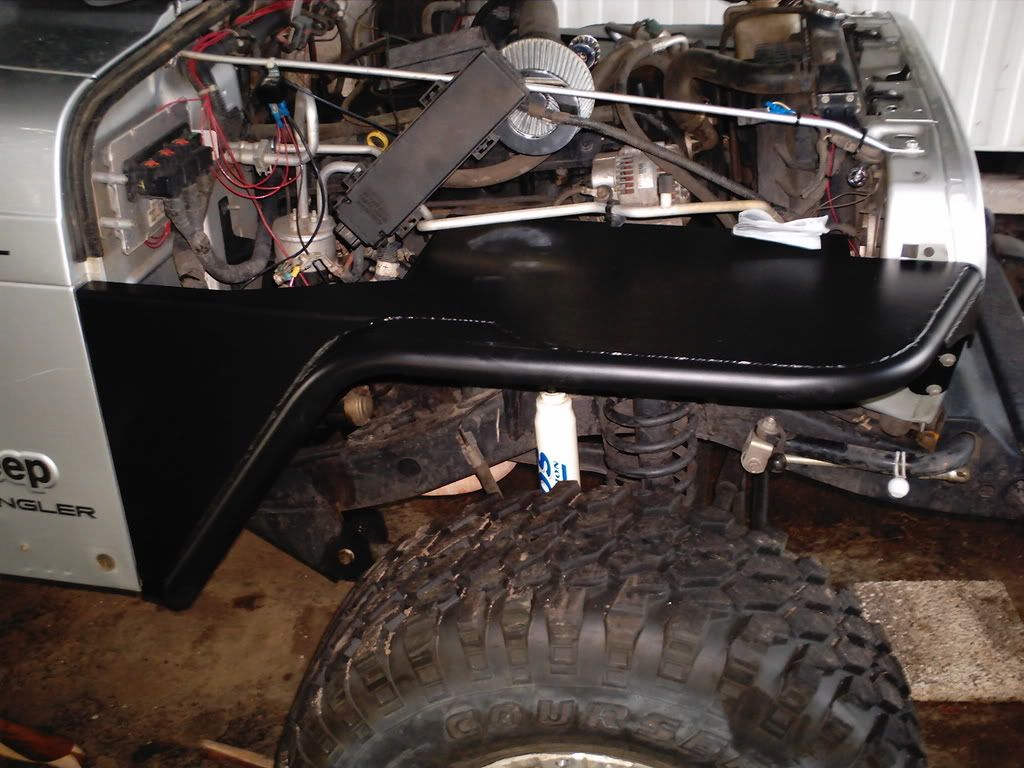

almost done…

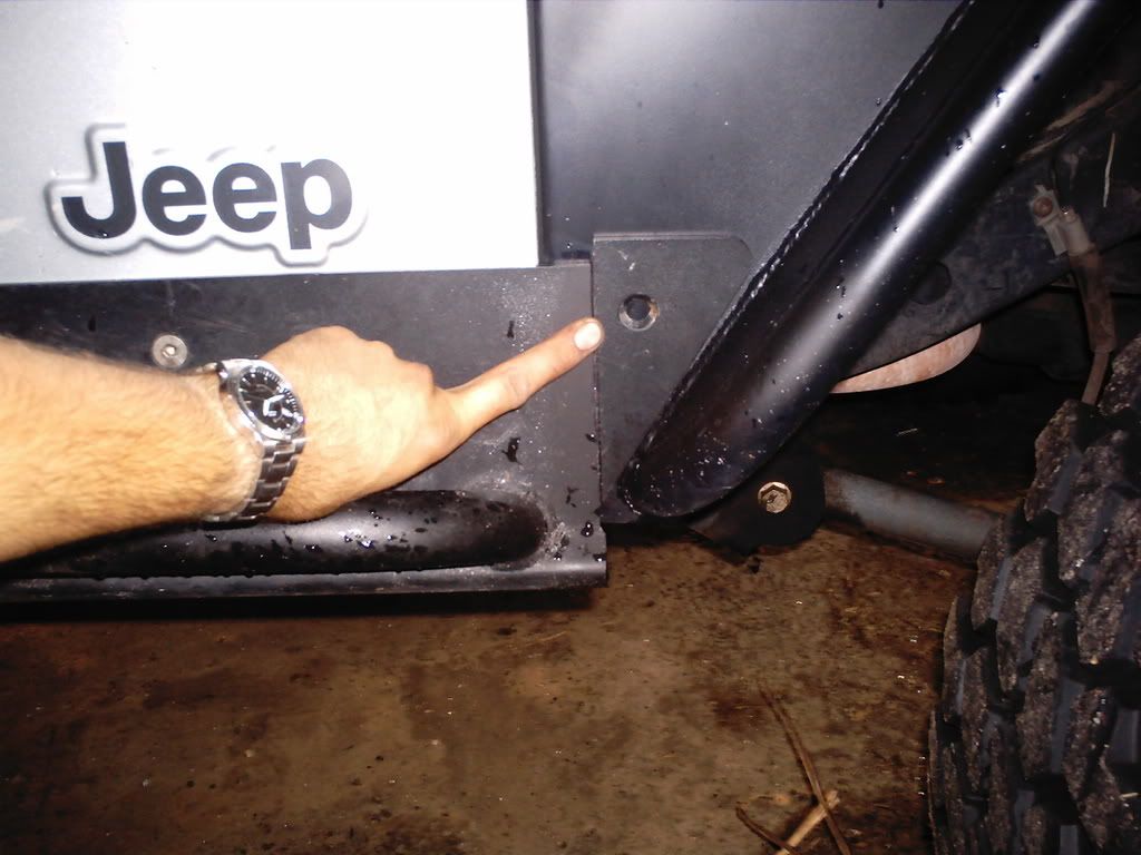

the acceserys will pretty much tell ya where to mount them.

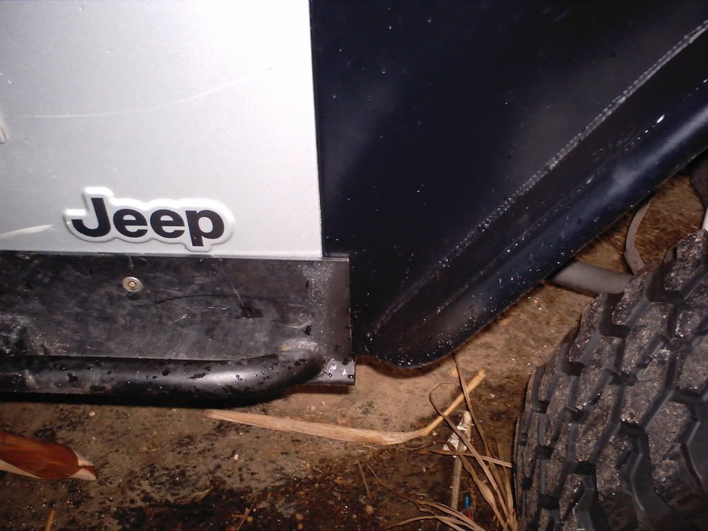

had to trim the sliders to fit…
gonna trim the cutoff to fit and weld back on when perfect…
dont forget to readust grill and tighten all bolts

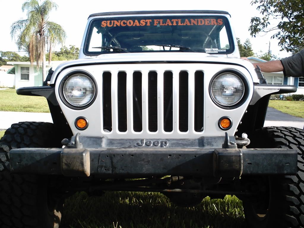

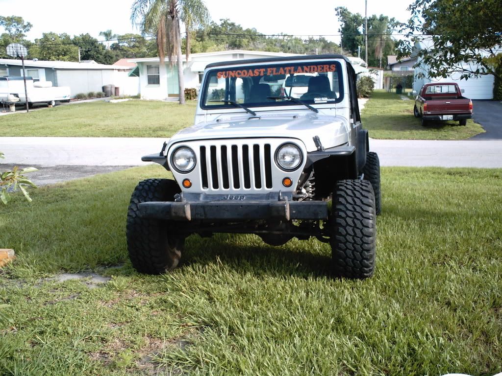

done
a/c lines are just twisted up slightly to clear fenders

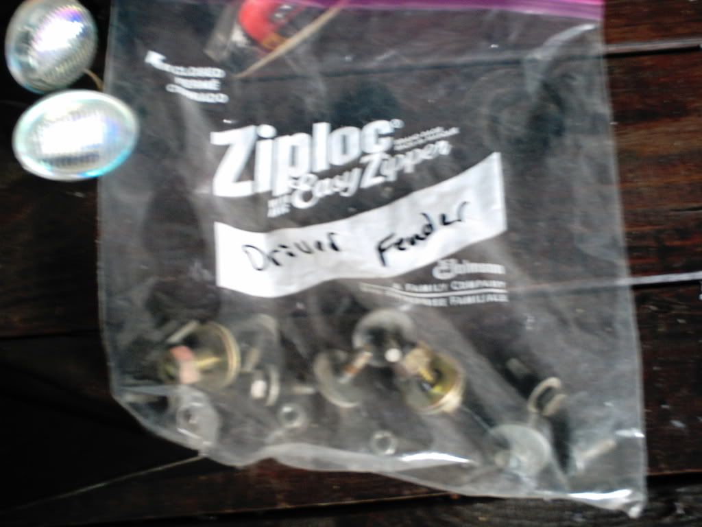

as a note to anyone trying this or any mod…
ziplock bags and a sharpie are your best friends!
Big Thanks To Pas And Chris For Helping!

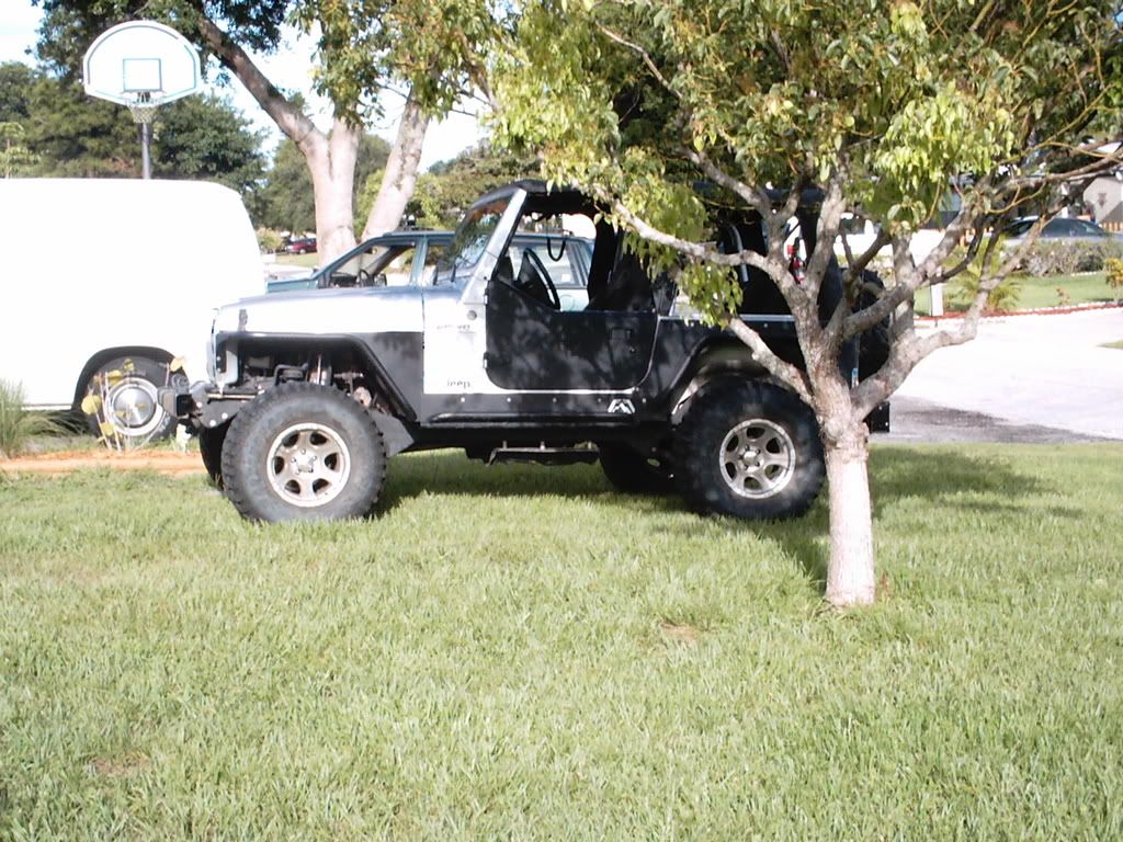

i finaly found a picture of one of the jeeps in my local jeep club… he turned it into a “motivational poster”… but it shows that the tnt fenders are strong. they were not damaged from this.
