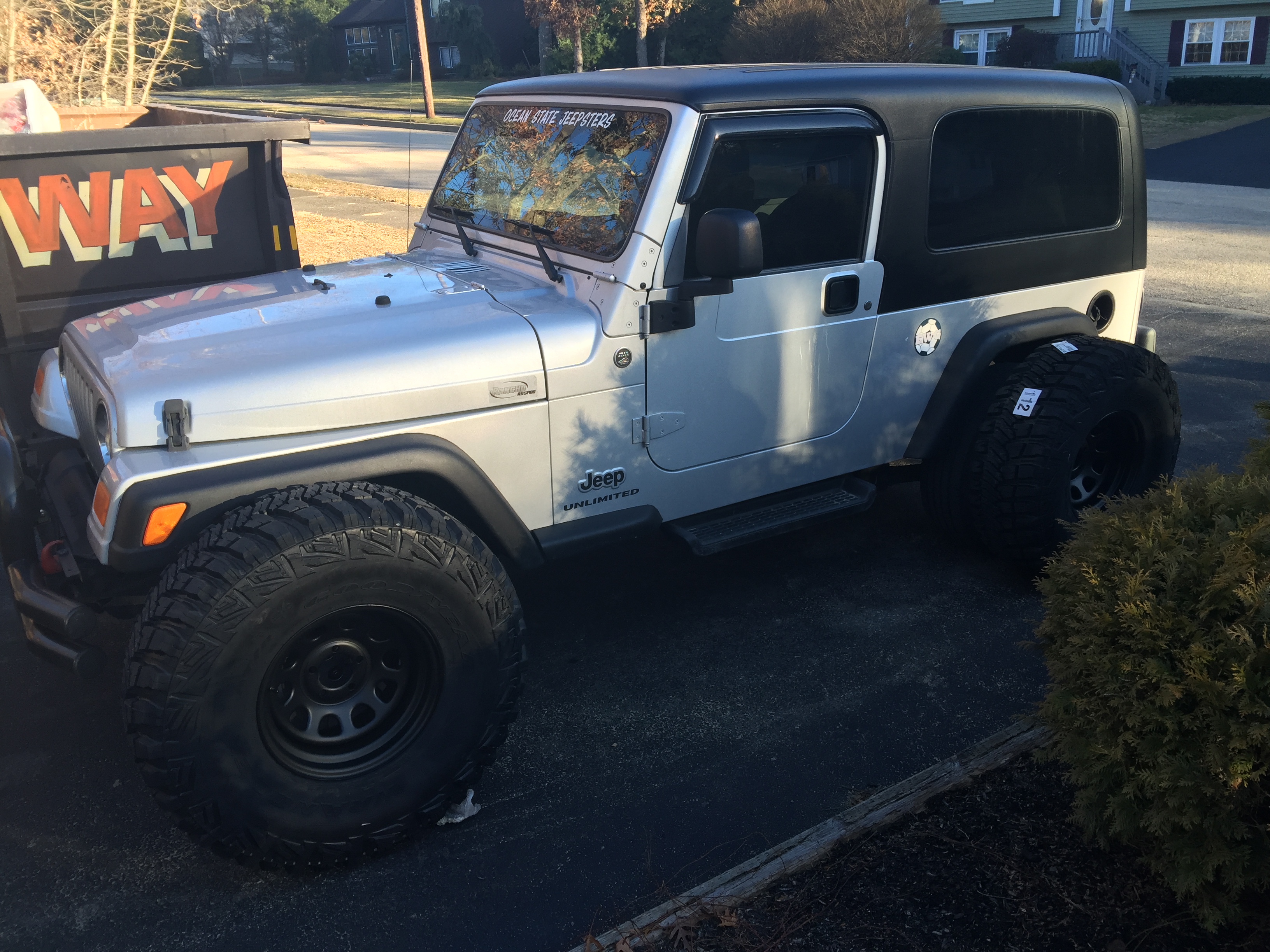

Who needs a lift
Double dually? … if not I’d say Matt needs a lift!
Sent from my SM-G920V using Tapatalk
We need to schedule this!
No lift just a sawzall

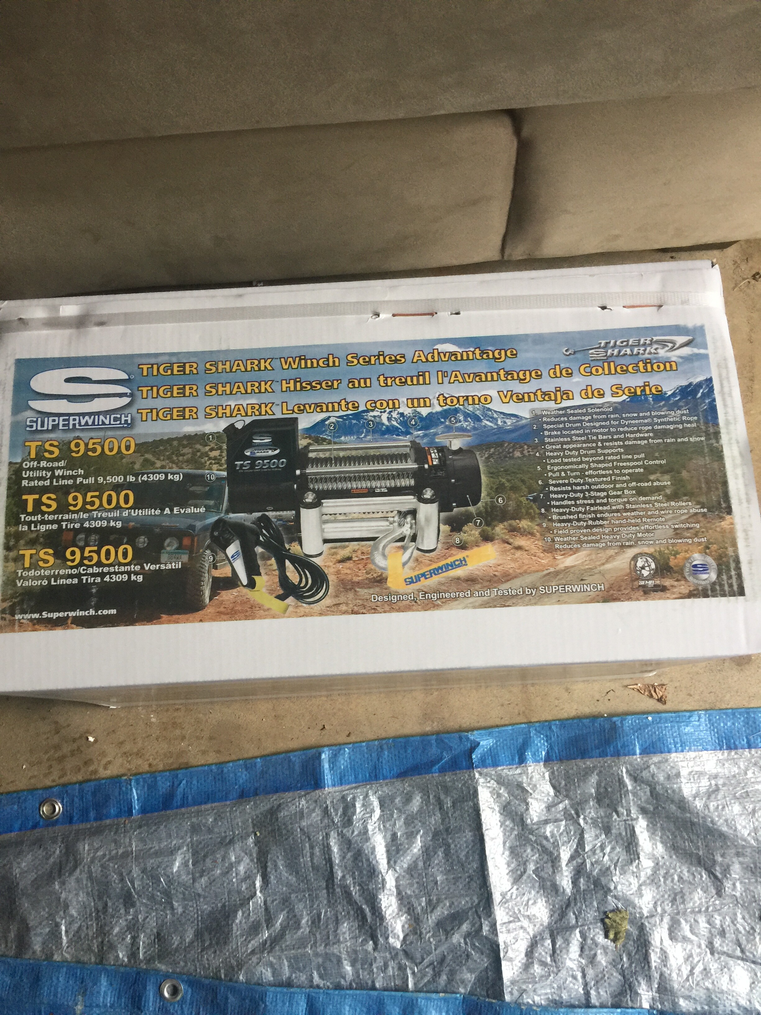

I miss my TS… That winch is awesome. buy yourself a $25 cover from amazon to keep the ice from the spool and it should last you a long time. Also check the controls. Mine had a bad wire on the “in” wire or a fouled contactor. The remote was the issue, but it was an easy fix.

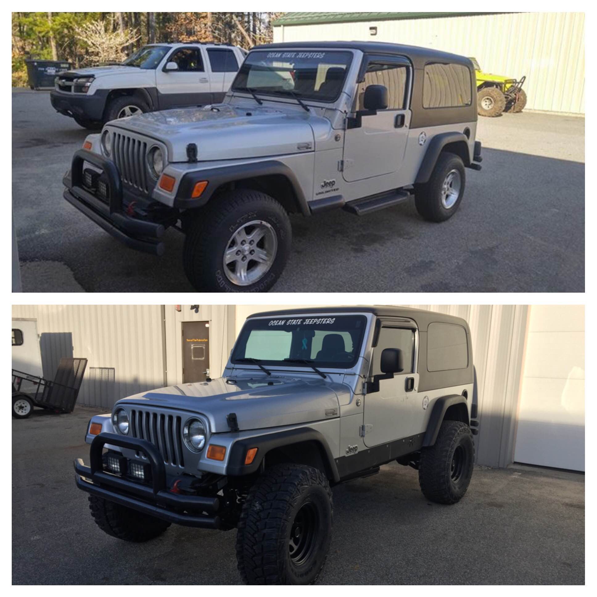

4" Iron Rock Ultimate Lift
1" Tera Flex body lift.
1" Big Dog Motor Mount lift
Ten Factory front Chromoly
Detroit front locker
35" MTRs
Poison Spyder Sliders
All installed at Barrette Fabrication. Rides perfect. (Stupid tube bumpers won’t be on for long.)
VERY nice. Now, it’s time to wheel.
Looks great I can’t wait to get my done.
Love it!
Looks great Matt!
