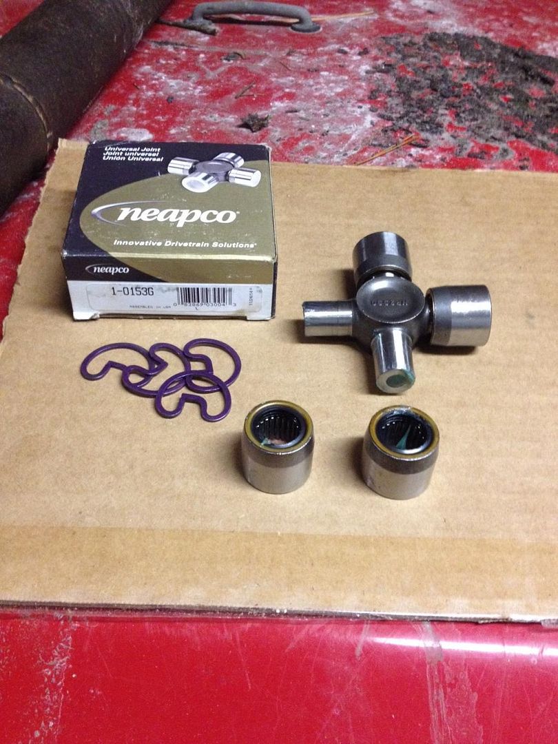

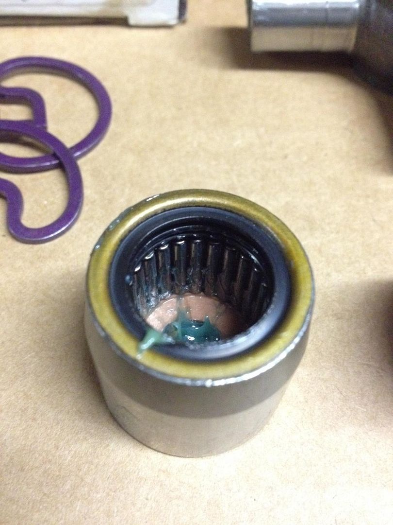

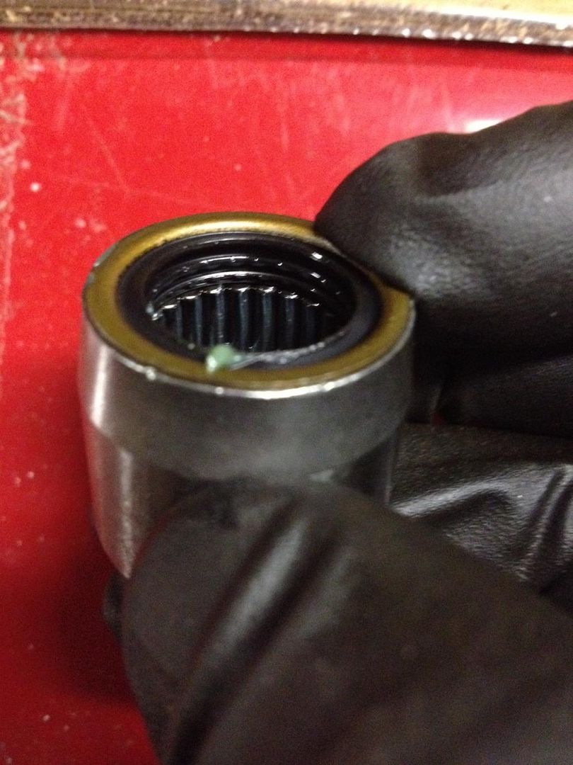

Thought I would share some pics/info on these U joint I just picked up. They are supposedly improved versions of the old “Brute Force” line by Neapco. They have nice metal/rubber seals, tapered caps, large needle bearings, and are service free. We will see how they hold up to some abuse this weekend. I installed 4 joints total: rear of rear shaft and all three in front shaft. I don’t think these are offered in a 1-0278 joint yet, so i used the 1-0153G for all 4.
