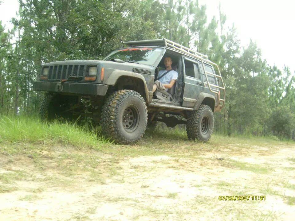

Will talk to Chris also (BigRed86) He has a roof rack and he does awesome with is set up

I agree that an exo cage will be overkill in the weight department.
As for exo’s my friend in FL had an AL exo. Light & Strong
