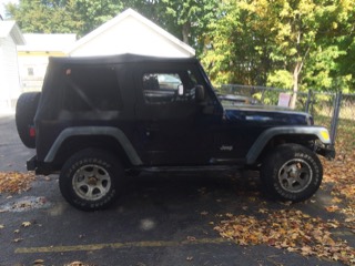

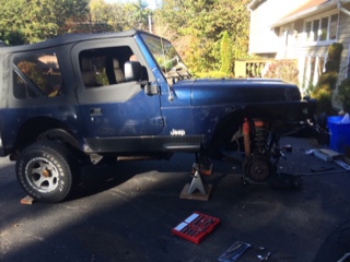

So I have had this jeep for over a year and have just about completely neglected it until now. Bought it stock with 120k a pos 2.5 block suspension lift practically falling apart with some worn down 31s
Couldn’t really find a good picture but that’s the gist, bone stock.

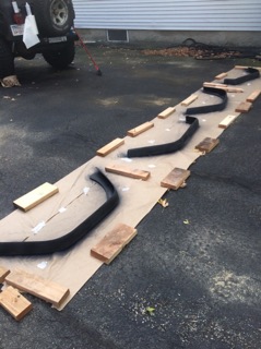

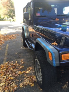

So while my tires and lift were in order I decided to do some chopping to those stock fenders
A little bit of painters tape a ruler and a harbor freight oscillating multi tool and voila
I did put the painting on hold for awhile until I had the proper amount of time.

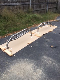

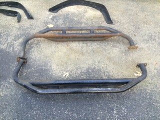

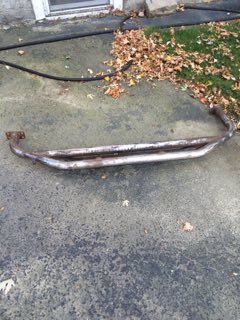

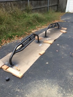

Next I decided it was time to freshen up my old rusty rocker guards. At first I thought a little sandpaper would do the trick but 3 hours later I discovered I was very wrong.ImageUploadedByTapatalk1413344233.265481.jpg
The struggle came with the cheap paint applied directly over the factory coat without any sanding or priming done. These things were a complete mess. But with the help of a few 4.5" grinder attachments it became a lot easier
So not sure why the pictures uploaded in reverse order but I guess that’s what I’m going with for now lol. Somewhere in here you will see 2 bare metal rocker guards ready for paint and than the finished
product. Rustoluem Hammered does do a pretty good job
ImageUploadedByTapatalk1413345307.499047.jpgImageUploadedByTapatalk1413345283.888078.jpg

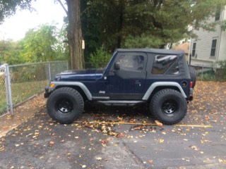

So now putting all of that to the side, the tires and lift showed up finally. Was pretty interesting packing all of the nonsense. I also just had to line up the new wheels to see how she would look. ImageUploadedByTapatalk1413344915.916636.jpginImageUploadedByTapatalk1413345265.062643.jpgImageUploadedByTapatalk1413345060.246091.jpg

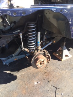

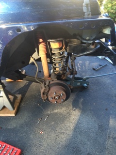

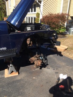

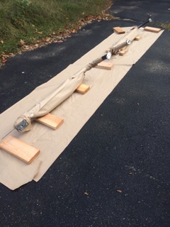

Now that all of the pieces arrived it was time to have a lift party with Matt here in the club. Hats off to him, without him this would of never have been done. Here’s a few install pics of the 3.5" RE super flex, billstein shocks and adjustable track bar. There was a point in time when things went down hill and I was too frustrated to keep taking picturesImageUploadedByTapatalk1413345745.536495.jpgImageUploadedByTapatalk1413345731.719527.jpgImageUploadedByTapatalk1413345716.066724.jpgImageUploadedByTapatalk1413345654.497107.jpgImageUploadedByTapatalk1413345637.876814.jpg

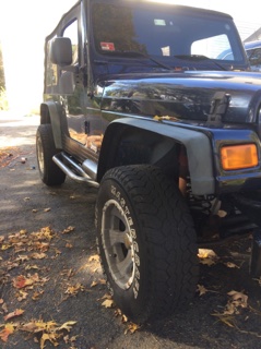

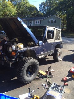

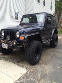

So after 13 hours of fun, 6 Home Depot runs, a couple busted knuckles and a few burns from hot metal shavings here is the finished product ImageUploadedByTapatalk1413346006.961971.jpgImageUploadedByTapatalk1413345989.878062.jpgImageUploadedByTapatalk1413345955.620873.jpg
Jeep looks great. Now time to get in the woods and bag it up on the rock and add some mud :smiley:
