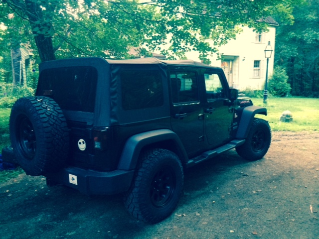

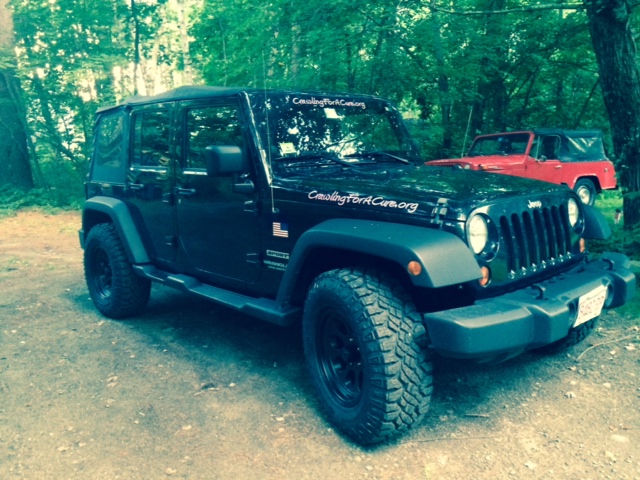

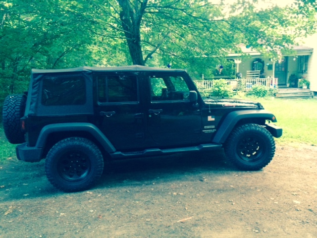

So I finally bit the bullet and got new tires a few weeks ago. Went with the Duralast 285s mentioned above and so far they are pretty good, if nothing else they look great and finally take the stock look away from my jeep. I have only had a few times where I had minor rubbing on the front air dam but other than that they are fine. have been running around 30-35 psi and the ride is fine.
No effect on acceleration with the 3.73 gearing and I think i lost about 1-2mpg at most since moving over. Road noise is not much louder than stock, they are a lot wider than the stock 32" tires but not too much taller and great for a daily driver.
Looks sharp!
Nice! Looks great.
