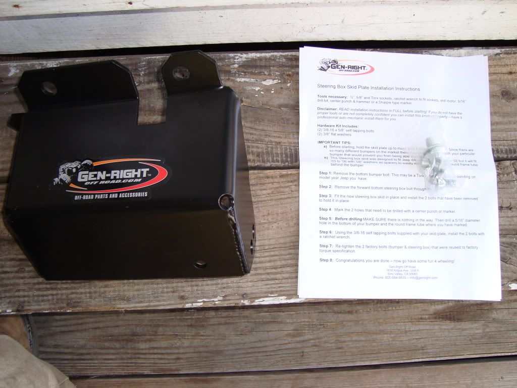

what was in the box

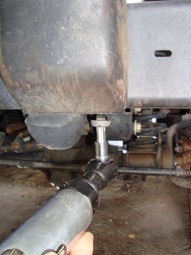

first remove bottom bumper bolt (torx 55t)

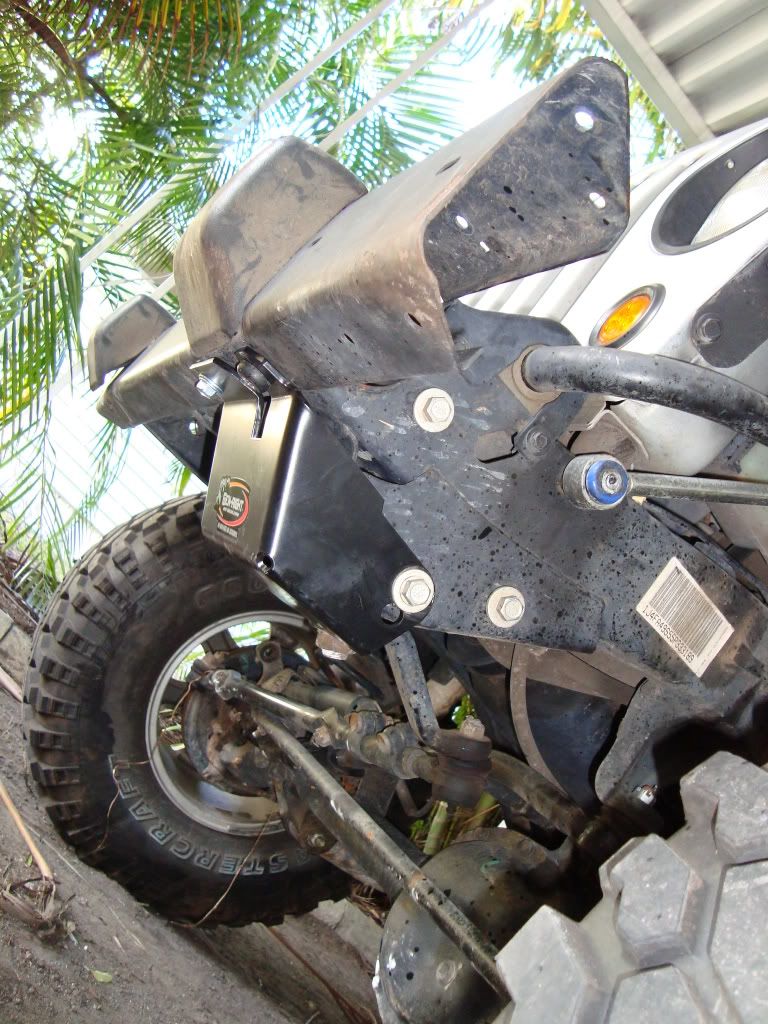

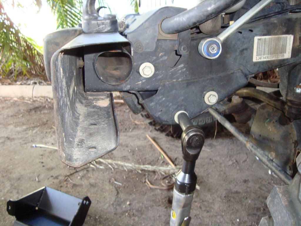

and remove the bottom forward most bolt from your steering box (16mm)
use the two bolts you just removed to hold the new skid inplace

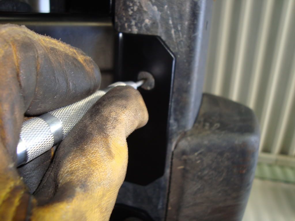

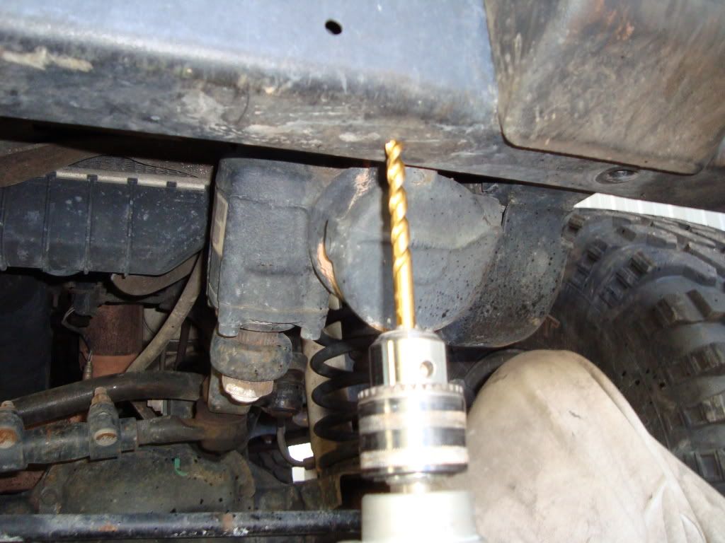

mark holes with a center punch and drill out with 5/16" drill

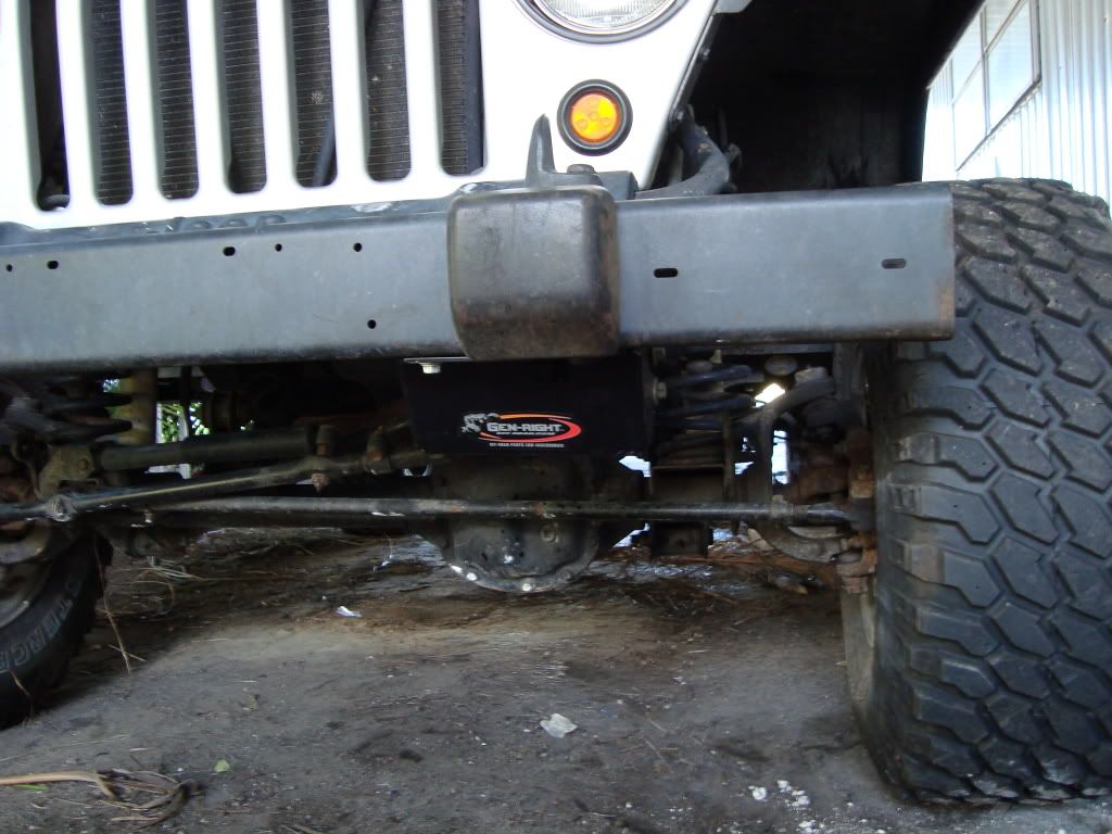

install the 3/8" self taping bolts and your done
