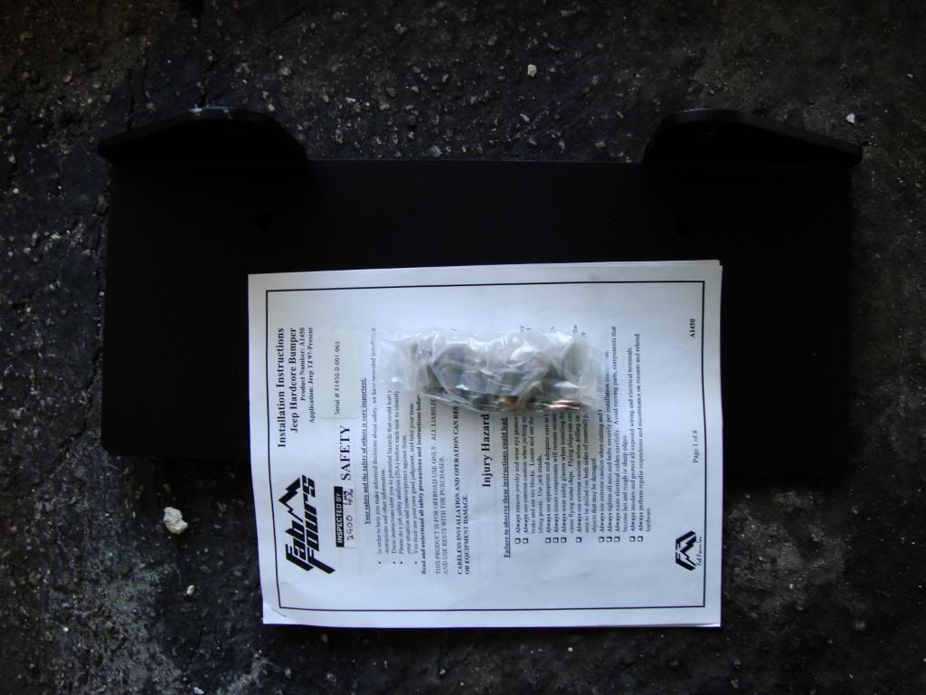

played with the idea of using the univeral winch plate…
can can we say hell no!

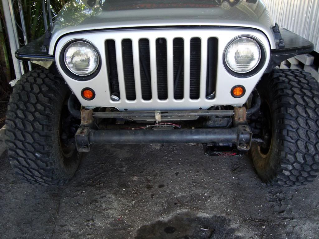

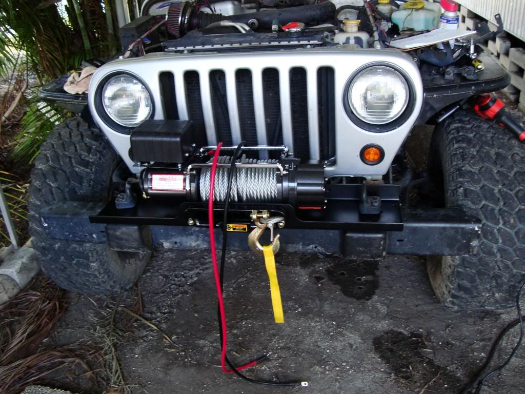

so first i removed the front bumper (torx 55 bolts)

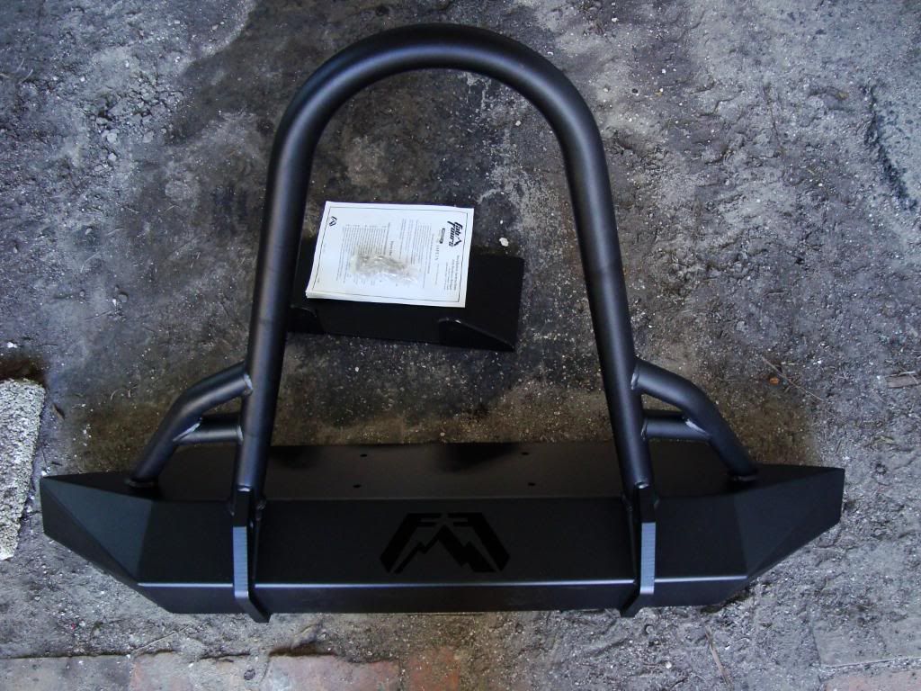

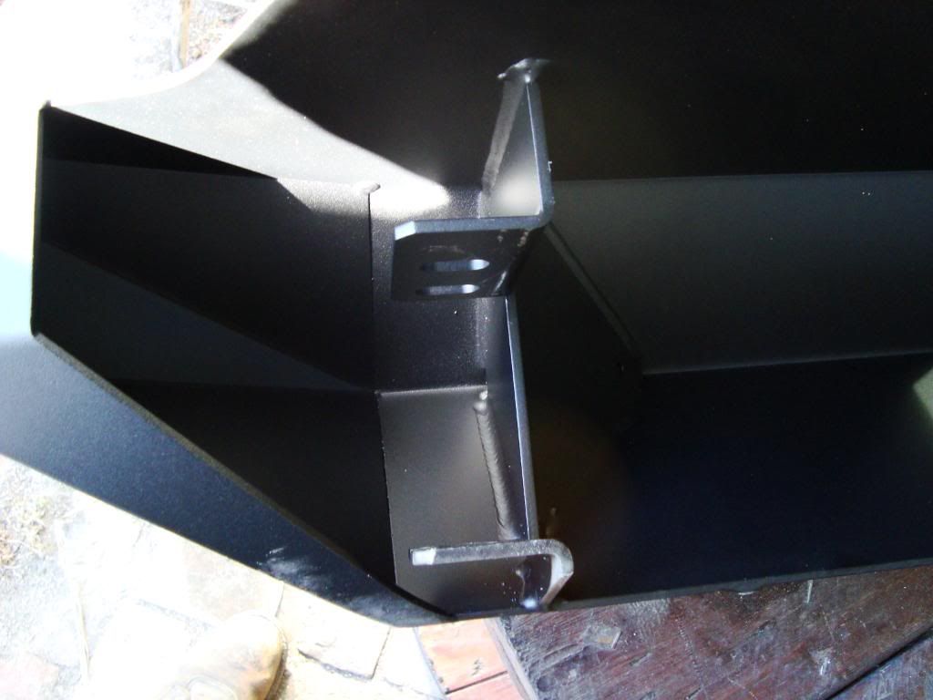

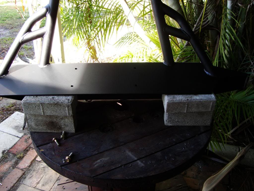

new bumper
i rested the bumper on some bocks

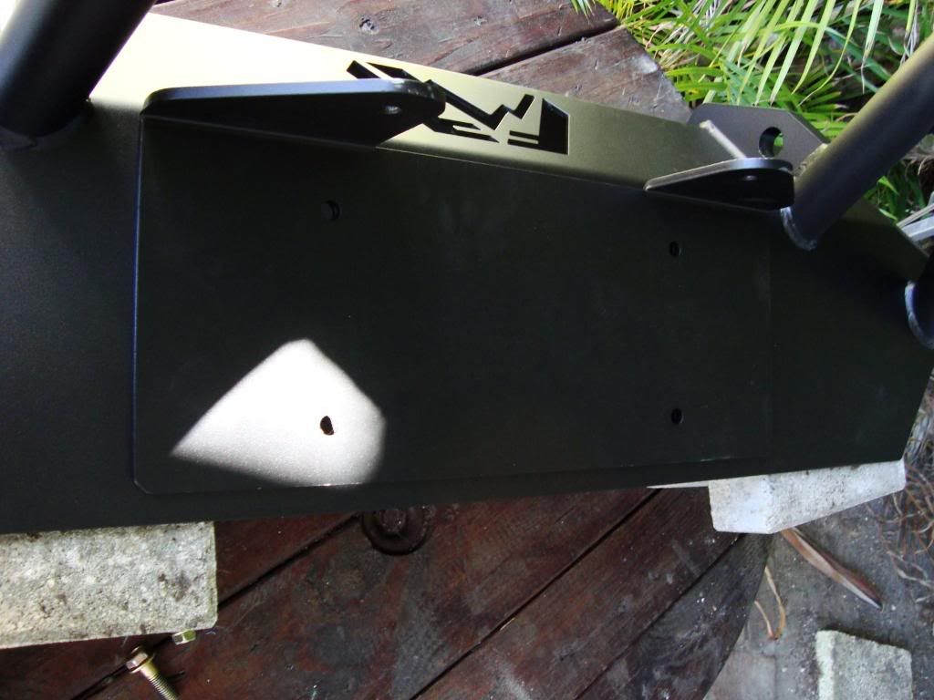

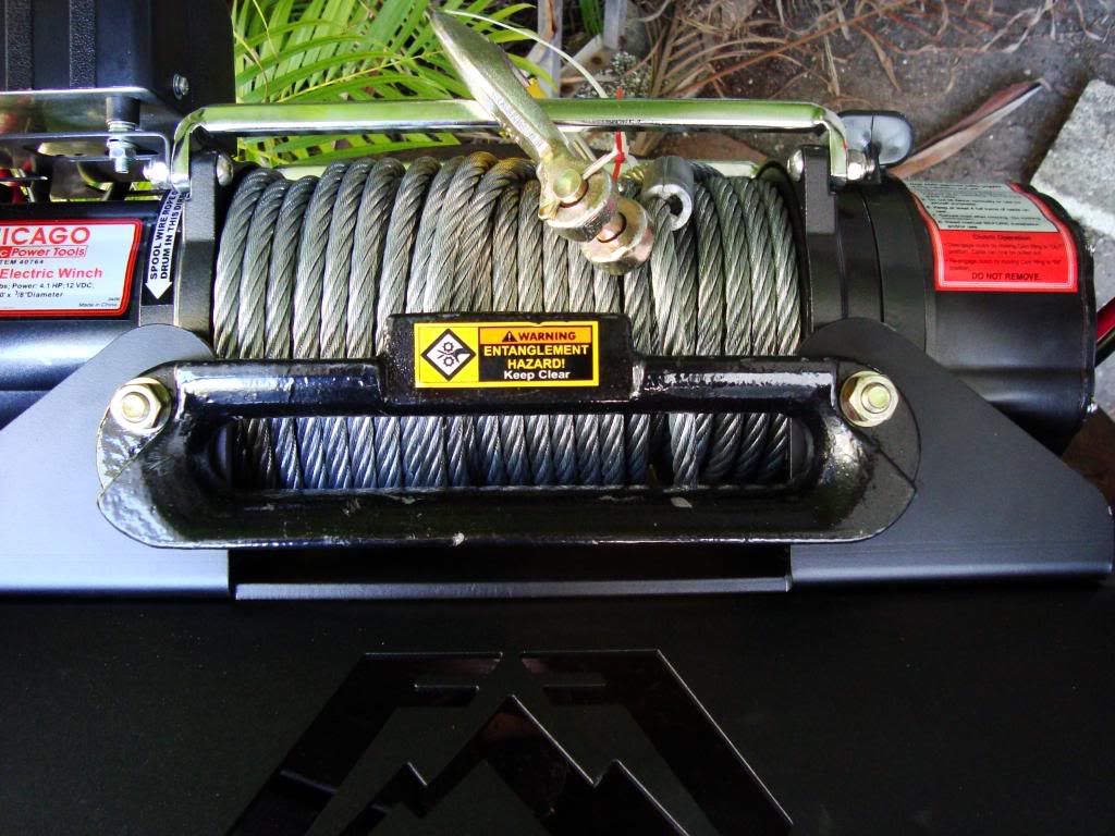

place the winch fairlead plate on
bolt the winch to the bumper (sandwiching the fairlead plate between bumper and winch)
(dont forget to install the fair lead befor installing winch

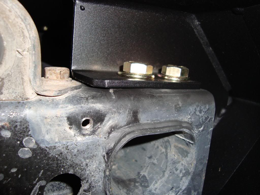

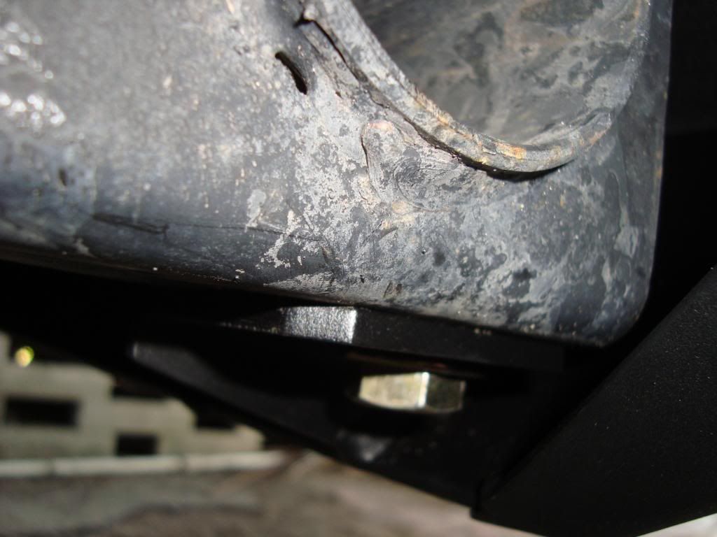

bolt bumper to jeep with 6 3/4" bolts

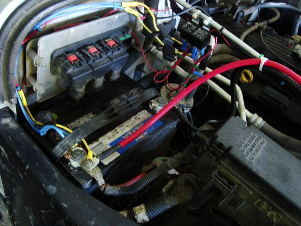

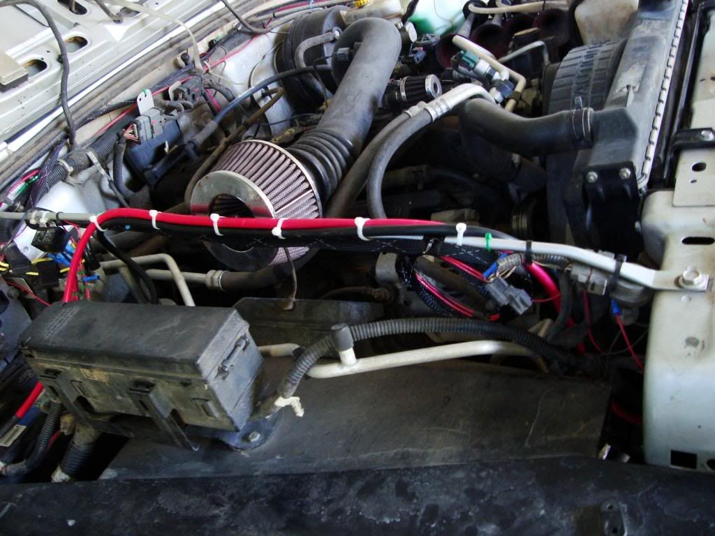

wire up the winch

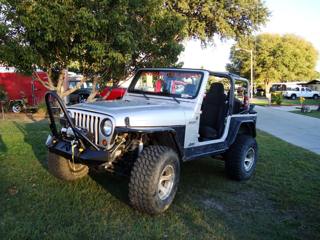

[imghttp://i213.photobucket.com/albums/cc238/YellowJK/fabfours%20winch%20bumper/DSC02965.jpg[/img]

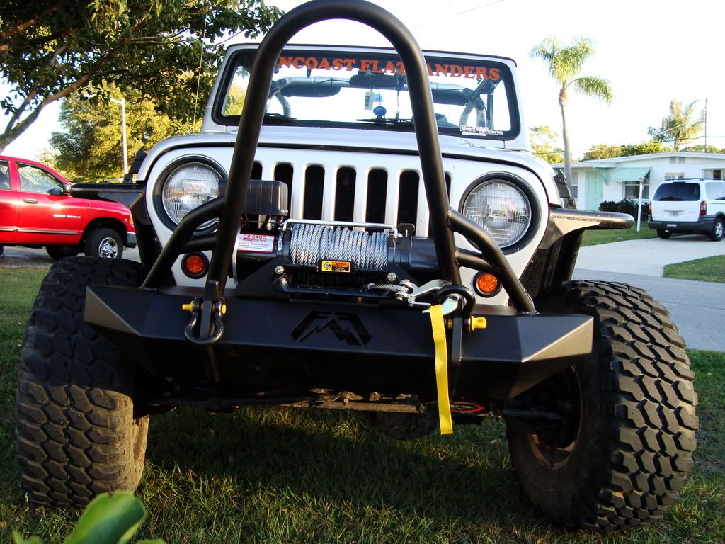

and lastly
DROOL!
