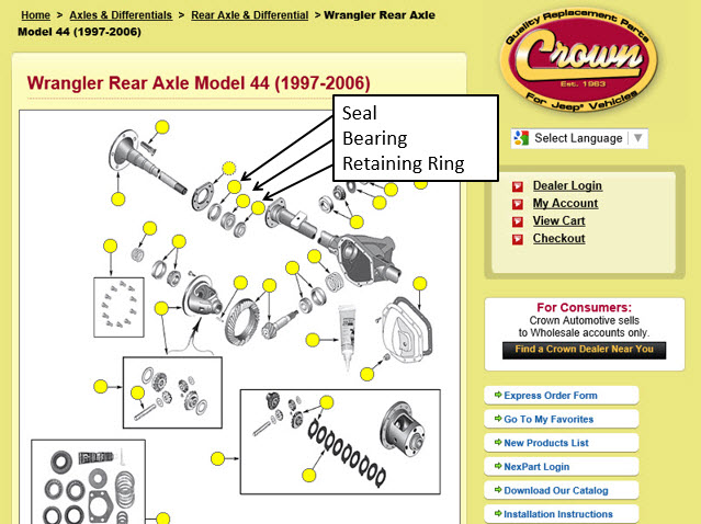

I’m not sure which D44 we are talking about above but on my rear D44 the seals are behind the bearing and retainer ring which are pressed on. A tall press is needed.
Thanks for the input guys , this is the rear axle it is the seal that is in the outside axle tube closest to the wheel that is leaking.
If its “flanged” style axle then the bearing and retaining ring must be pressed off to replace the seal. I have never seen a bearing survive getting pressed off. I would also not reuse the retaining ring.
A quick look at the Crown Automotive web site seems to indicate that all Wrangler TJ D44’s are of the flanged style.

Jeff at Crown has the parts:
crownautomotive.net/category … le-44.html
Thanks doesn’t seem to bad to do , probably a little longer to do with the locker in it but not to bad.
OK i just ordered two seal and bearing kits figured might as well do both of them. What’s the best way to get the retaining ring off the axles and new ones on? I plan to buy a 12 ton H press this week as I need it for other projects on the jeep. Any special tools that I might need?
