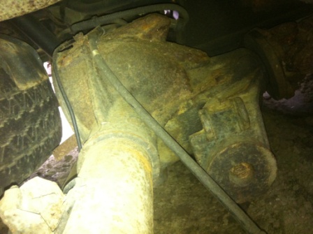

Can anybody identify this as an 8.8. In was in a 99 ford explorer 2 door. The weight on the housing is throwing me off.
Check the Bolt Pattern on the cover. Scroll down there is an Identification chart near the middle of that page.
http://www.differentials.com/technical-help/differential-identification
The weight is on there for a vibration damper. It can be removed and thrown away
looks like the right one. there should be a tag under one of the cover bolts. unbolt it to check the numbers. you will need a conversion flange ($50ish) or a conversion ujoint- 1310/1330 ($27)

unfortunately I could not reach or see the tag. I have already picked up the M.O.R.E install kit (perched & shock mounts), e-brake cables & conversion flange. Can this be done without a SYE ?? I know if i don’t install it now then ill have to readjust the pinion angle later (re-weld or shims). Id like to do a SYE now as well a get rid of the t-case drop but this project keeps growing and funding is minimal.
i think you can get away with it for now.
