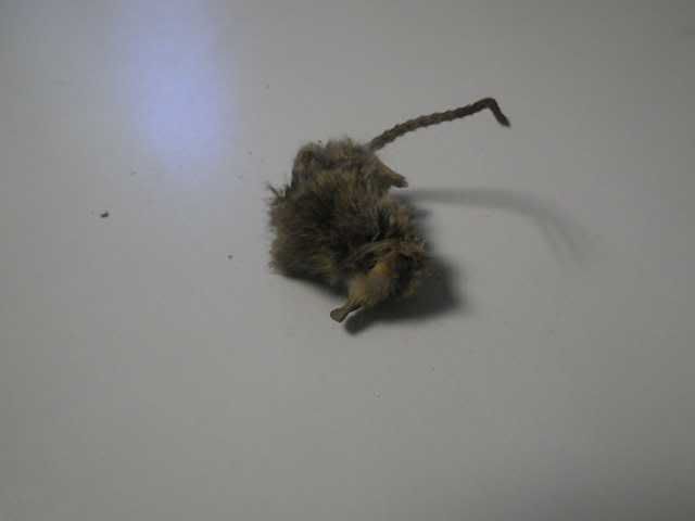

Pulled off the center console in order to replace the t-case shifter. Found a mummified mouse wedged in next to the body control module:

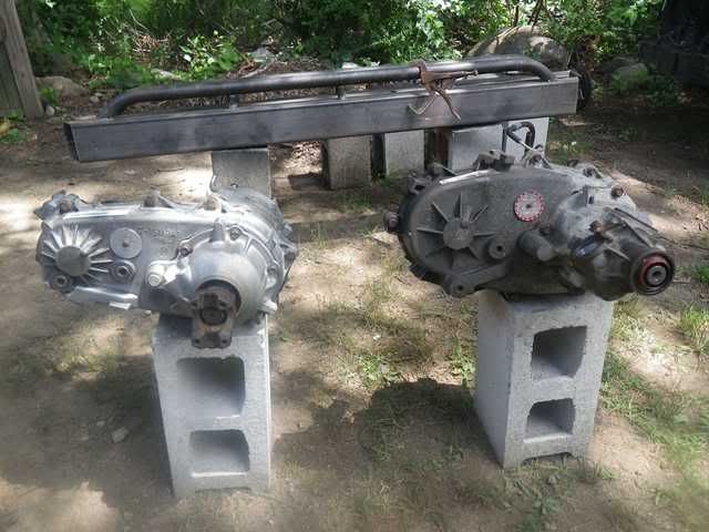

Swapped in the built NP231 from my old rig:

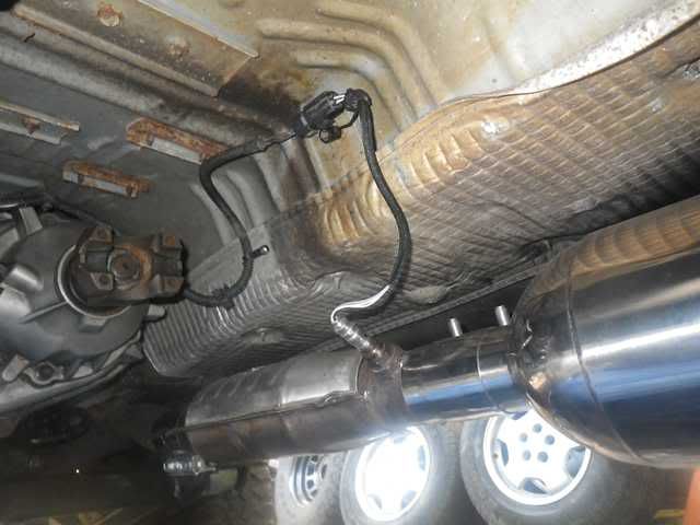

Exhaust is in. Still need to add a hanger in front of the rear axle. The factory setup does not have one but its absolutely necessary for off-road use:
